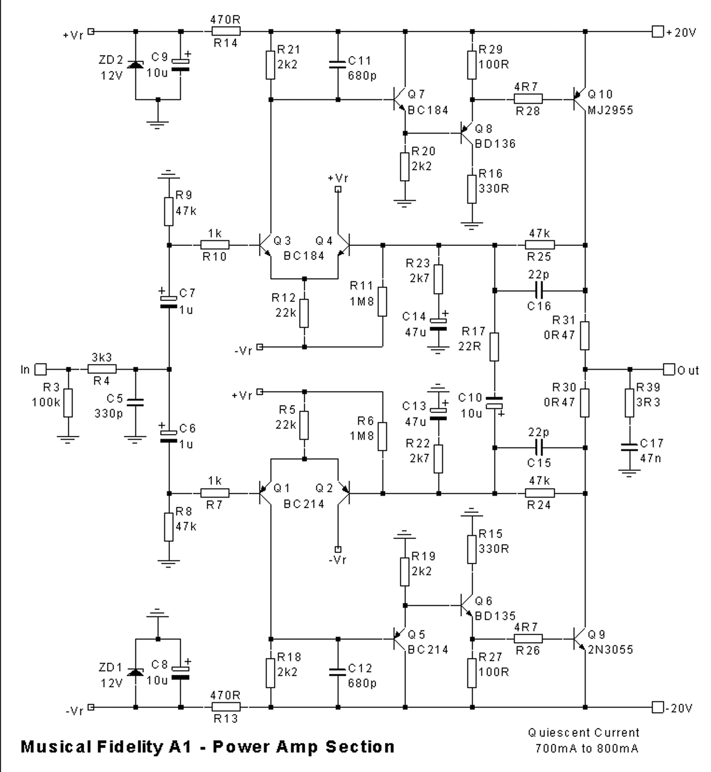

Vă prezint un amplificator clasa A , proiectat de Tim de Paravicini ( ( Musical Fidelity A1 ) .
Desigur , poate fi îmbunătățit prin folosirea unor tranzistoare finale mai performante .
Remarcați modul de manipulare a raspunsului armonic prin folosirea R11 și R6 ...

I-as da o sansa, in viitorul apropiat (la primavara incolo), cu MBT3906 si MBT3904 (buna sugestia cuiva
) in loc de Q1-Q4. Finalii 3281/1302. Dar sa fac intai "primitivul" asta de Hiraga.
In plus, cum arata deja bine originalul, parca si eu tot sus as pune "suportul de tigaie/aragazul/radiatorul"
Control armonic, ce fac diodele alea acolo? De aici vine schema: https://www.markhennessy.co.uk/mf_a1/technical.htm
As to Class A, people cannot get into their minds the analogy with tube amps and realize that the two halves of the circuit are additive so that total available current is 1600mA [he assumes a standing current of 800mA] and the peak is about 2.3 amps. Power consumption of a push-pull class A amp is 50 percent efficient so 20 watts per channel times 2 is 80 watts from the mains. As a final proof, if the amp is driven into an 8 Ohm load with a sine wave at full output the heat sink temperature fell by more than 10 degrees. Because 40 of these watts is now in the load.
Tim de Paravicini
Tim de Paravicini
